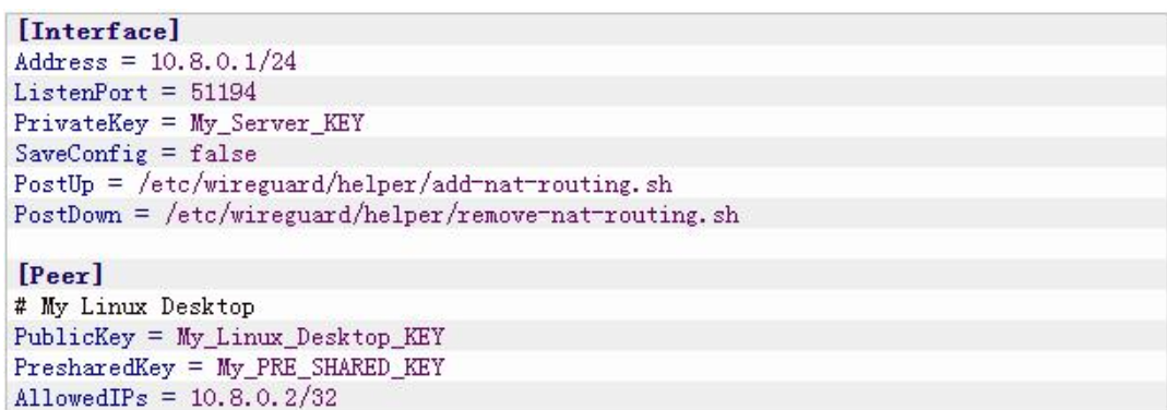

如下更新您的/etc/wireguard/wg0.conf文件:
# vim /etc/wireguard/wg0.conf
附加在[Interface]部分:
PostUp = /etc/wireguard/helper/add-nat-routing.sh
PostDown = /etc/wireguard/helper/remove-nat-routing.sh
如下图所示:

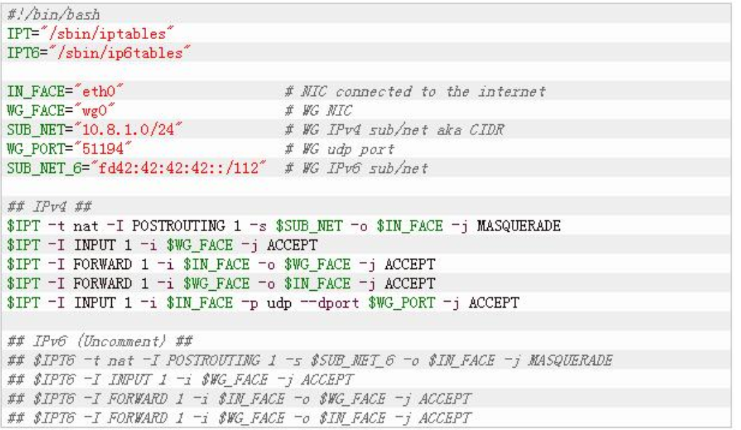

包含使用cat命令显示的add-nat-routing.sh :
# cat /etc/wireguard/helper/add-nat-routing.sh

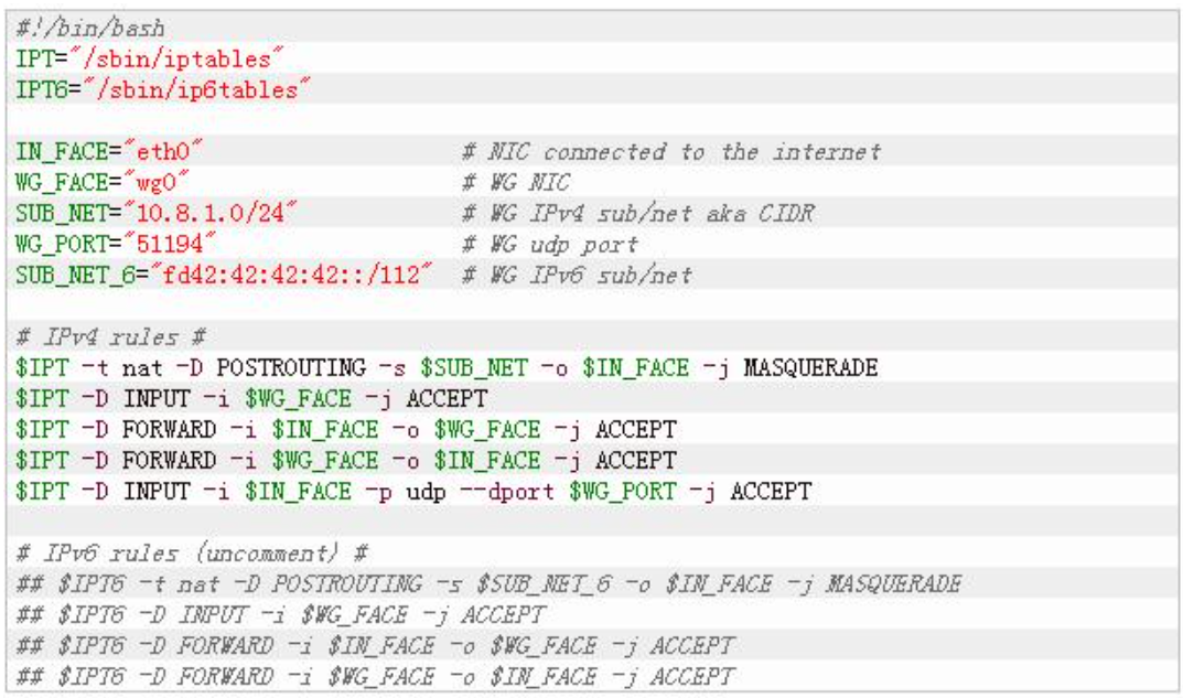

和:
# cat /etc/wireguard/helper/remove-nat-routing.sh
